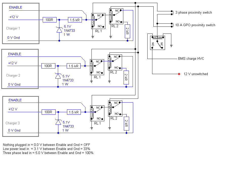

OK so just double checking, I have drawn the schematic above correctly? Switching between high power and low power is possible with the correct relays on the 12 V - Gnd as per the TC manual?
I'm looking at doing a similar thing for my 2 x 2 kW chargers for the race bike. Since most racetracks have terrible power facilities, I will try not to exceed 15 A at 240 V. Since it will be a race bike I should be able to dial it back with a couple of three position toggles rather than relays.

jonescg wrote: OK so just double checking, I have drawn the schematic above correctly?
It looks OK, but note that the "12 V" output from the charger is unregulated, and is more like 11 V in practice, at least with the sample of one that I've tried. So either adjust your resistors accordingly, or better yet use a 5.1 V zener diode as a crude regulator and the source of "full on" voltage, and derive the other two voltages from that.
Your two volts or less case may as well be 0.0 V, saving a resistor. So then you only need 3.0 V from 5.1 V.

OK, I have re-drawn it to incorporate a Zener diode (regulating the 5.1 V supply) and made the circuit applicable for running three chargers.
I also realise that I would need some fancy triple pole triple throw relays rated for 32 A which could switch the charger AC inputs from 3 x (phase to neutral) to (3 phases common) to neutral. That can come later...
Make sense? Does it look like all three chargers may be toggled between off, low and high power? I have also included a master relay to turn all three chargers off should the BMS spot an overvolted cell. Not sure how it will work, but that can be sussed in good time.
