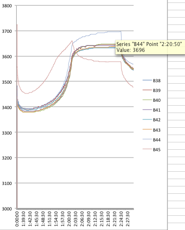

roddilkes wrote: Hi Barney,
What is your peak charge voltage?
That is, what is the highest voltage your charger gets to before switching off?
Hi Rod. I can answer this one...
I have noticed 2 different figures: 165ishV (in feb12) and 161V (last week, aug12).
Back in Feb I was noticed the floating charge process seemed out-of-whack (cant recall what I actually noticed, now, but I had been away for 4 weeks in January and someone else was keeping it charged up). Anyway, this particular night I did watch the main meter in the car every 30 mins or so, and at the time added notes on my 'smartphone' (aside: those phone makers have a way with words, eh?).
That evening (22feb12) charging had started around 6:15ishpm (I know, I know, but I wanted to watch it without staying up til all hours).
At 9:25pm, the pack voltage was climbing slowly towards 164.7V, and the ZIVAN charger was pushing 19.4A in. The apparent capacity was 96.9%.
By 9:35pm the Amps in had slowly dropped from 7A to 3A and by 9:35pm was 0.7A.
By 10:20pm the gauge reported 164.6V and 100% capacity. But not until 10:47pm did the Zivan beep, beep beeeeep its 'finished ok' tones and turn off.
Presumably this was some top-up charging process going on; normally the topping out is much quicker.
A few months later whilst charging I noticed it was hitting 161V and stopping. The long drawn out step from 96% to 100% seems to have gone. So 17may12 it stopped at 160V, capacity 99.6% at 10.30pm (cant recall when charging started, probably 8 or 9pm). Last week it was similar, voltage climbing to 161V and Zivan beeping finished without the long slow close of February.
By the morning the pack seems to have settles back to 150 or 151V. Does that tell us something?
hth, Barney

Maybe something amiss there I don't know for sure.
Can you use the cell loggers to measure the cells as they are approaching end of charge?
It would be useful to have this info just to check if the ones that are weak are getting fully charged.

The point is that a few cells are sagging below 1.8 V while the others are still above 2.5 V.
antiscab,
These BMUs bypass 600 mA at 3.65 V so I don't understand why you'd be concerned with a charger putting 500 mA in for another hour to ensure balancing, as jonescq suggested. Sure 3.5 V at 0.001C is full, but are you saying significant damage occurs by taking them to 3.65 V at 0.0001C for an hour?
drgrieve,
barney's system is designed for top balancing. He's trying to figure out what, if anything is wrong with his existing system. I think you're just confusing the issue with your bottom-balancing-derived statements.
Overall battery-voltage tells you almost nothing about individual cell voltages. But it's clear that 161 V is not enough to ensure top balancing of 45 LiFePO4 cells. In an extreme case you could have 35 cells fully charged at 3.65 V and the other 10 nearly flat at 3.325 V.

So we have a number of hypotheses:
1. High R connections e.g. loose or oxidised terminals or links.
2. High-R cells (temporary) due to being out of balance.
3. High-R cells (permanent) due some kind of abuse such as over-temperature, possibly combined with a lack of cell compression.
So come on barney, test some of these hypotheses. You're keeping us all in suspense. Image
Are your cells compressed in any way? i.e. prevented from bulging their cases when hot?
Did you choose to have the optional temperature sensing with your EV Power BMS? If so, how often do you have a thermistor between cells? Every second cell?
By the way, the EV Power is an extremely reliable BMS and any charging problem is far more likely to lie with the choice of charger (e.g. one that is designed for Lead-acid, not Lithium-ion) or how the charger is set up, or the manner in which the charger is controlled by the BMS.
Please do what both Rod and I have suggested and datalog some cells while doing a normal charge. Up to and including the end of charge. Of course you should ensure that you include some good and some "bad" cells in the set being logged.

Next pics are the data from data logging during a charge cycle. I picked a set of 8 in the upper pack, pack B, so I could get to them easily. I chose batts 37-45 as they include both good ones (eg #38, #41, #44) and a very bad one, #45, the one nearest the leftmost power lead in the upper pack photo provided above.
The logging ran for c.2hrs, and the spreadsheet is long so its a screen grab in two parts. Which suits both the 150K upload limit, AND saving me hosting the pics on my site and you relying upon two servers to be running rather than one.
First the 99 datapoints (why did it stop then?).... There are some discontinuities in the data suggesting charging ran to the end (eg the drop off around 14 min) but I dont get it. Tell me if this is rubbish data and I'll just delete it and try collecting again. Is 99 points per file the CellLog recording limit? Here is hoping the graphs align next to one another...
Image Image
And the data points themselves... A long file, in two parts, using Excel conditional formatting to colour the cells from Orange (lowest voltage c.3275, to Yellow (highest V, c3515). Note all the cells are 4-digit whole numbers representing 3dp voltages from 3.275V to 3.515V. Also to the right is a sum of all 8 cells giving a pack voltage for those 8 cells, ans finally a CALCULATED voltage as tho these 8 cells represented the whole pack - ie the projected voltage for 45 cells (which of course they do NOT, but it gives an _idea_ of the whole pack); to which Ive applied more conditional colouring as a bar chart, longer= higher voltage.

My guess with the logger is it still had old files in memory and it ran out f space. We use 30 sec logging and can record for up to a week. You need to do the control shift and control alt to spread out the graph using the mouse wheel to find the 24hr points to separate the days but the graphs give a good general idea of how things are going.
From your graph it would appear cell 45 has lost capacity or has a high resistance joint but it could be inside the cell to one or more of the pouches. We had a few cells that did strange run away charging like that but a constant voltage charge of 3.8v on those individual cells brought them back into line, I doubt the BMS card would appreciate that sort of sustained voltage though. We charged for an hr, let the cell stand for an hr, if the voltage dropped below 3.5v we charged again, some took 3 goes before they settled down. We do this with all the cells we use before we put them to work now, charge them till they will hold 3.5v rested, seems to save having to pull battery packs out and sort out the recalcitrant cells... always wanted to use that word some where :lol:

Unfortunately that charging data, while not exactly rubbish, doesn't cover the part of the charge we are most interested in -- the end. Although, as you say, those jumps in the curves imply gaps in the record. If we really are looking at the end of charge there, then something is very wrong since most of the cells should have got to 3.65 V before charging terminated.
What happens around 14 to 15 minutes is pretty interesting, if it is real. A couple of possible explanations as per T1 Terry.
1. A high resistance joint spontaneously reduced its resistance back to near normal.
2. A cell that was near zero SoC got enough charge into it that its internal resistance reduced to near normal.
I know which one I'd put my money on.
No need to do any great discharge before trying again. That would just risk doing more damage to the low cells. Discharging just 1% of capacity would probably be enough, and then log the charge again, hopefully after figuring out what went wrong with logging last time.
To be convinced that I was looking at the end of charge, I'd want to see cells ramping down from 3.65 V after the charger shut off.

Cant resist putting the graphs up now. These might be interesting.
Charging of the whole traction pack from 70% to 100% usu takes 20%/hr plus any levelling time at the end, usually quite brief. THis year this levelling period has been much more variable. Tonight it took 2.5h to charge what would normally take 1.5h.
Actual data later.
GraphAug12 PackB 38-45 0m to 1h38
GraphAug12 PackB 38-45 1h38 to 2h30...

I can sort of explain why some cells are high and some cells are low, the charger looks at total voltage across all the cells and charges to an average, if a few cells go high during charging all the other cells must remain low for the average voltage to remain the same. I'm guessing the cells that ramp up quickly have lost capacity either though a poor connection internally or through one or more of the pouches within that cell being damaged by over voltage charge.
This one is fairly radical but if the cell is damaged anyway you aren't going to make it worse. It you charge the wayward cell you can get to easily to 4v it may be enough to clear the high resistance connection and the cell will settle down with the rest of them. If it doesn't work the cell will remain pretty much the same as it is now.
Can you tell us more about what was happening in the second graph? It shows cell cell42 went high this time but cell 45 is not fully charged, is there more graph available? Maybe leave the logger running longer after charge finishes to see where the cells settle to.
The charger from Hobby King I posted the link to earlier can balance charge 6 cells at a time through the cell logger plug but you would need an adapter plug and lead to bring the cells into groups of 4 so the pack 8 cell packs can be balanced in 2 seperate groups.
With the logger, don't run any power saving modes and don't solder the link between seven and eight as shown on the Endless Sphere site, the logger part stops working correctly if you do.

A note on terminology: When the red LEDs are on on the BMUs we'd normally say they were "bypassing" or "in bypass". "Floating" is not something we normally do with Lithium cells, and if we did, it would have to be at around 3.4 V, not 3.65 V.
That's all still rather inconclusive. We really need to know what kind of charge profile the charger is supposed to be using (plain constant-current constant-voltage (CC-CV) or something more complicated?), and whether the charger is controlled by the BMS master, and if so in what manner (merely on/off, or including a reduced-current stage for balancing).
Do we know if the charge was terminated by the charger itself, or by the BMS master turning the charger off? If by the charger itself, is this based on time, or the current falling below some threshold? If so, what threshold or what timeout?
Presumably the BMS master will only turn the charger off if any cell goes over 4.1 V. Is it wired up to do that?
Does the BMS sense cell temperatures at all? i.e. are there any thermistors connected in the BMS daisy-chain and poked down the slots between cells?
Does the charger sense the cell temperature. i.e. is there a temperature sensing cable going from the charger to the battery as well as the positive and negative charge cables. Its temperature sensor would typically be glued inside a lug bolted to a cell terminal.
Ideally, to be able to make sense of these voltage curves, we'd need to see the current logged along with the cell voltages. I don't suppose there's any way you can do that. Wristwatch, pen and paper?
Like, what the hell happened at 1:37?
Both the fact that all the red LEDs did not come on, and the measured voltage of 164.4 V for 45 LiFePO4 cells suggest that the charger voltage could do with being tweaked up a little. It needs to be definitely greater than the voltage required to put all cells into bypass at the same time. There will be some tolerance on the nominal 3.65 V bypass voltage of the BMUs so we should perhaps allow 3.7 V per cell, which would be 3.7*45 = 166.5 V. But assuming the charger doesn't have a lower constant current mode for balancing (e.g 0.5 A), if we go too high we risk having some cell go to 4.1 V and shut off charging before they all achieve bypass. So it's quite a balancing act. This method of charging LiFePO4 cells is very unsatisfactory, and becomes more so the more cells you have in series.
But there's no point in playing around with charger voltage until we eliminate the possibility of high-R connections. That possibility has not been eliminated by this charging data.
I suggest that the next step should be to unbolt, clean and rebolt the terminals of cells 44 and 45 only. And then repeat the charge cycle with the same logging (plus current logging if possible). There's no need to discharge more than about 5% before doing the charge since the first hour and 20 minutes of the previous charge was pretty boring.
