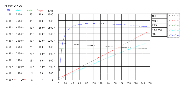

However I was just reading your blog. What "250cc performance" do you think you will get? I was looking at a Ninja250 which does over 600Nm at the wheels in first gear. So a Mars@300A is about 33Nm so a gear ratio of 18.2:1 gives you the same performance. However at 72V this is about 4400RPM which is 27km/hr. Lets say you geared the Mars at 5000RPM to get 100km/hr Gear ratio about 5.6:1 33Nm@300A is about 185Nm at the wheels. less than 30% performance of a 250cc. And it gets worse for drive train losses, wind resistance, rolling resistance etc. It will be a good eV motorbike but I would hardly say it will have 250cc performance. Make sure you take lots of pics for your blog! |

Richo: I think you're comparing apples and oranges, the power curve of an electric is so vastly different to a petrol engine, peak torque is at zero rpm instead of 8200rpm (for the Ninja 250R).
Maximum power for the Ninja 250R's engine is 24kW @ 11000rpm. Maximum power for the Mars is about 20kW at 2000rpm - and more importantly the power curve is a lot flatter. I'll be very interested to see how this conversion goes, as I've been tempted to do something similar myself. I know a bunch of people with 250cc motorbikes so once Matt's electric is done we can find out which is quicker

We could look at it from another perspective. Lets say he could get 185Nm at the back wheel continuous up to 100km/hr. This is a force of just over 600N at the wheel. Taking into account the bike + rider this is an acceleration of 2.63m/s^2. So to get to 100km/hr this would be about 10.6sec. Now compare a GPX250 0-100km/hr of 5.75sec. I don't need to know the power curves to see who is going to win. Even still I think it is a good conversion and will prob be one of the better one around. |

Where did the figure of 33Nm @ 300A come from? The torque constant of the ME0709 is 0.20 Nm/A (http://www.zeva.com.au/media/Mars_ME0709.png) so at 300A it'll put out ~60Nm of torque -> 1090N at the wheel -> 4.78m/s^2 -> 0-100 in 5.81s.
Of course this is neglecting (a) transmission losses and (b) the likelihood that 300A wouldn't be sustainable up to 100km/h due to back EMF etc.. But then I submit to you that very few riders would be able to get a GPX250 to 100km/h in close to 5.75 seconds, launch control and shift points are so critical.. Problems you wouldn't have with a single speed electric. I think it's in there with a chance..! |

Now I agree.
It's that old data I have again. I must delete those old power curve sheets I have. (0.11Nm/A) Sorry.
